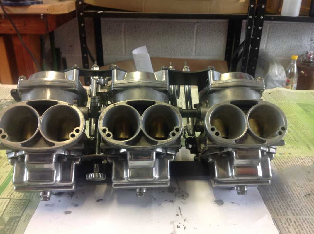

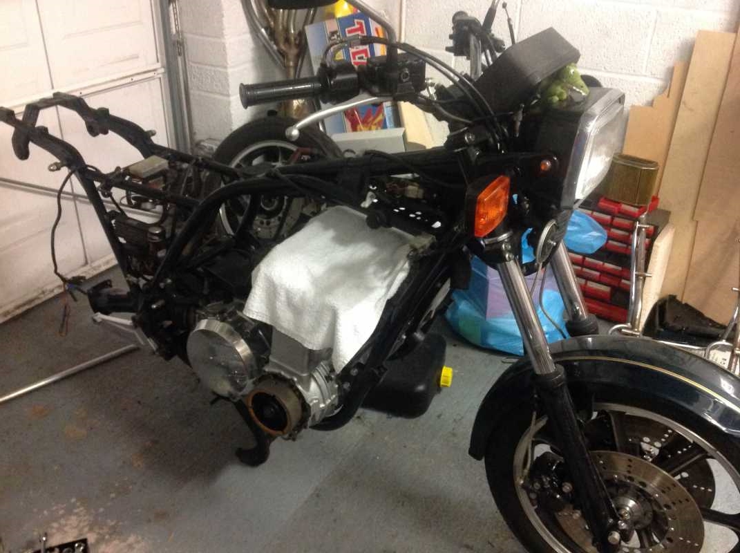

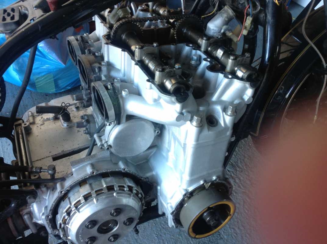

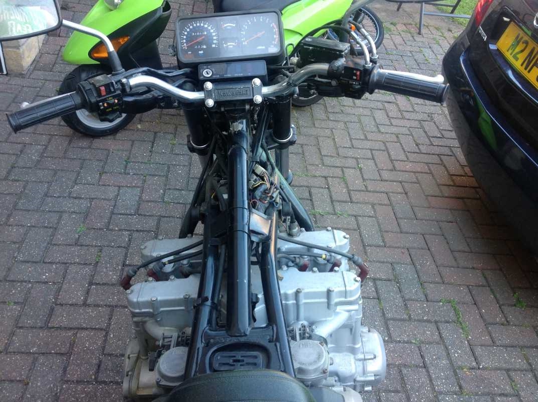

Some initial pics, will start taking a few more. So far I have claened every electrical connection ( still have a green tinge in some of them so probably will change the whole connector).The swing arm and a few untidy areas of frame around the shock mounts have been rubbed down and repainted. The area under the carbs and the front crankcase have been repainted with Frost Restoration high temp silver paint and everything is being polished as I remove it. I bought myself a polishing wheel and various compounds to do the job, however, it is very time consuming and a filthy job. I used a dremel based polishing kit to get into small areas. One job I am finding hard is the rear final drive case; I am not weedy but I do find it heavy and therefore to hold it at the polishing wheel for any length of time is not easy. On top of that the casting of the case is rough and does not polish easily. The valves have been done- I found three valves worryingly tight with virtually no clearance but luckily no damage seems to have been done. The carbs unfortunately failed a leak test on the float valves so they will have to be changed as there are no overflows on these carbs. Also the tee piece which feeds petrol into the carbs is now weeping so I will probably have to make one that will take replaceable O-rings.
I am replacing every bolt with new stainless ones and all the plastic parts have been repainted with Sunox plastic paint which does a fab job.
I used Consomic inside the tank and then sealed it with gas tank epoxy resin- inside it looks like brand new. That's about as far as I am, back to the grind when I get home tonight.
