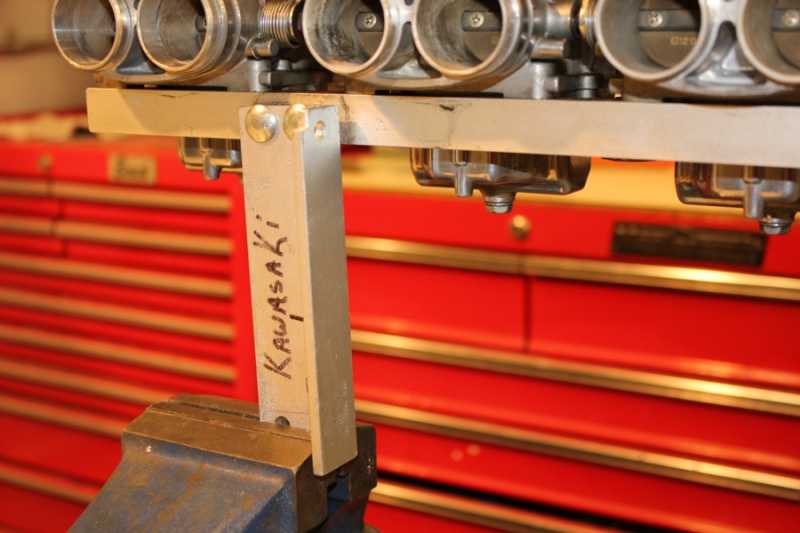

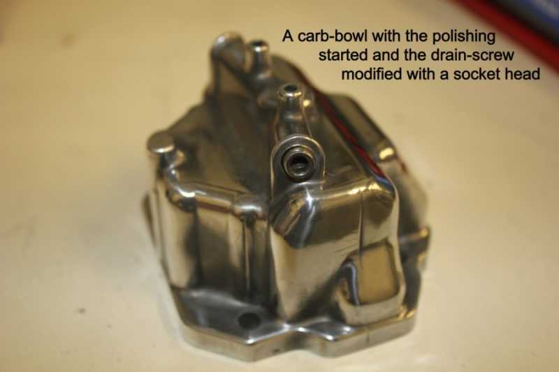

My understanding of the float-bowl configuration has been: The centered-single 10mm bowl is 1980 and up. The 1979 bowl had 2 nipples (only 1 drilled to drain) with a drain screw on the side.
First photo (bank of carbs) - 1980
2nd and 3rd photo - 1979
