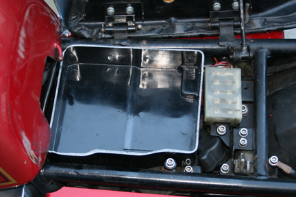

I am looking for a cap to the air filter used as a tool tray

Thanks for the sites. I have never thought I was cheap but I will not pay 100.00 for some plastic tray.

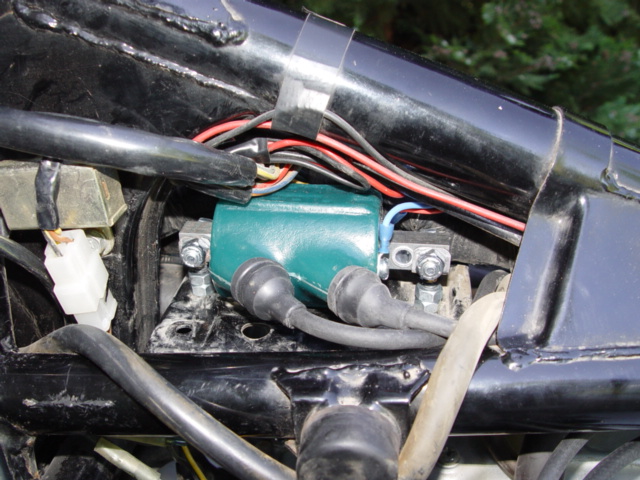

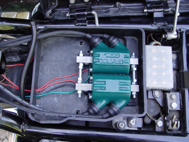

kza13 wrote: What are the coils and where can I get them, i'd love to be able to get rid of the big yellow coils I have now under the frame, always have to take them off to get at the rocker cover, do they fit straight in or do you have to run the resistor ???
Hey Petes,
Those coils are Dyna brand 3.0 ohms (no ballast resistor needed). I've mounted one where the top coil usually goes. The remaining two are in the tool tray. I wondered whether or not the different length wires would be a problem. Several folks, mechanical sorts, told me that I'd have problems with my computer (none on the bike)or possibly my radio (I'm ridin, what do I need music for?).
Here's the reason: I recently installed a manual cam chain tensioner. I had my doubts about the instructions so I wanted to really check the tension on the chain. Here's what I had to do: I removed the fuel tank, I removed the cam cover. Total time: 20 minutes. Think about the shiite you'd have to remove with three coils in the stock locations. (I've previously removed all of the air injection trash.)
I forgot to mention. The bike romps!!!
Sorry Pete1958. Back to your topic. My other 1300 doesn't have that tray.
