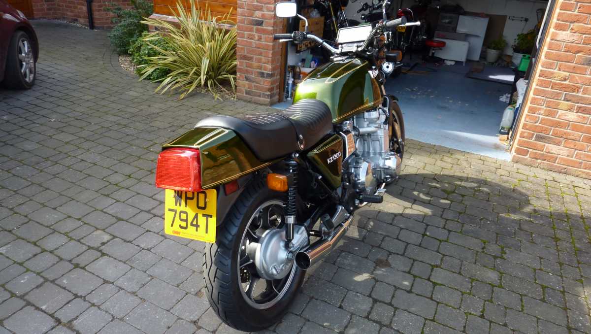

Paul, I took the original bars off my A1 a couple of years ago, as I found them uncomfortable: I had a spare NOS set of Suzuki GT750 Kettle bars which fitted straight on my bike without any drama's.
Here they are fitted:
They've the same height / pitch as the Kwak items, but about an inch widers as they do not turn in on your wrists as much as the original bars. Its a personal choice, but I much prefer them: that said it might just be familiarity as Ive been riding Kettles for years :whistle: .
Cheers Tim

Thanks Tim
at least i have another option although the kettle bars may be as rare as the z1300s on another note just noticed the reg on your bike is very similar to mine which is WPO 788T
