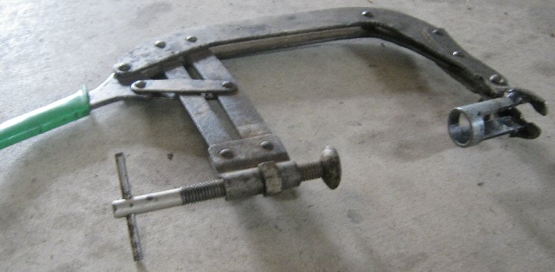

I did the seals a while ago, had the head off during a re-build, I am an average aussie and ain't got any spare dosh (money), I had an automotive spring compressor and tried to use that, because of the angle of the springs and valves and the width of the head I found I couldn't compress them enough to easily take the retainers out to free the valves, so I cut a piece of pipe and tacked it onto the compressor foot, cutting out the sides of the pipe allowed me to easily get at things, make do when you have to, worked for me
