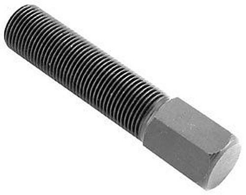

I don't have this tool nor have I seen it BUT there are several listed on EBay and one of them suggests that it's a M18X1.5 thread. Obviously it's been hardened in order to do it's job. I would imagine any of the automotive tool stores would be able to bring one in for you. It's a fairly common size for a number of different applications. EBay lists it for $8.95.
Have a look in the center of your mag and see if you can see the internal thread. The tool should screw into the mag and be pushing on the end of the crank.

Being a novice, I wasn't sure if the magneto puller was required to help pull the assembly off. i.e A thread in the magneto puller theoretically would end up pushing it against the three bolts therefore helping to pull off assembly.
What I am understanding from your post (rightly or wrongly?) is the rotor puller is all that's required?

That being said, I found pics of the magneto puller and the rotor puller on pages 273 and 274 of the manual and when I blow the pics up to 200% I can see the magneto puller is a 3 legged puller that bolts onto the magneto and IT has an internal thread that the rotor puller threads into. The rotor puller will be pushing against the end of the crank pushing the magneto puller and magneto off of the crank. The crank has a taper on it as does the magneto so this assembly is going to come of with a substantial force and then bang or crack or snap (put your favorite word here), it will fall off.
I know that sick feeling your having but in this case I think you're ok. Ideally it would be nice to use the designed tools but I wouldn't hesitate using a 3 legged puller similar to what we call a steering wheel puller and bolt it to the magneto with 3 bolts in the face of the mag, I guessing that there is 3 threaded 6mm holes on the face of the mag
so 3 6mm x 30 or 35 mm bolts then screw the puller bolt in against the end of the crank and get about 20-30 lbs of torque on it then give it a crack on the end of the puller bolt with a hammer as shown in your pic on the first post. Be prepared to catch the puller and mag assembly because when it pops, it will literally hit the ground if you're not prepared to catch it.
Just 1 word of caution, you used a piece of steel on the end of your previous set up and might have marked up the mag bore. Maybe find a slightly smaller piece of steel to do this with just in case that piece is a little too big and is jamming up on the rotor, otherwise I think you're ok. Oh, and before I forget, that puller tool I originally posted won't do you any good in this case now that I see the exploded pic of the mag puller on page 273. Sorry for the confusion. Like I said "the blind leading the blind" but if no one else is going to step up here and give you thoughts to ponder then I will.
