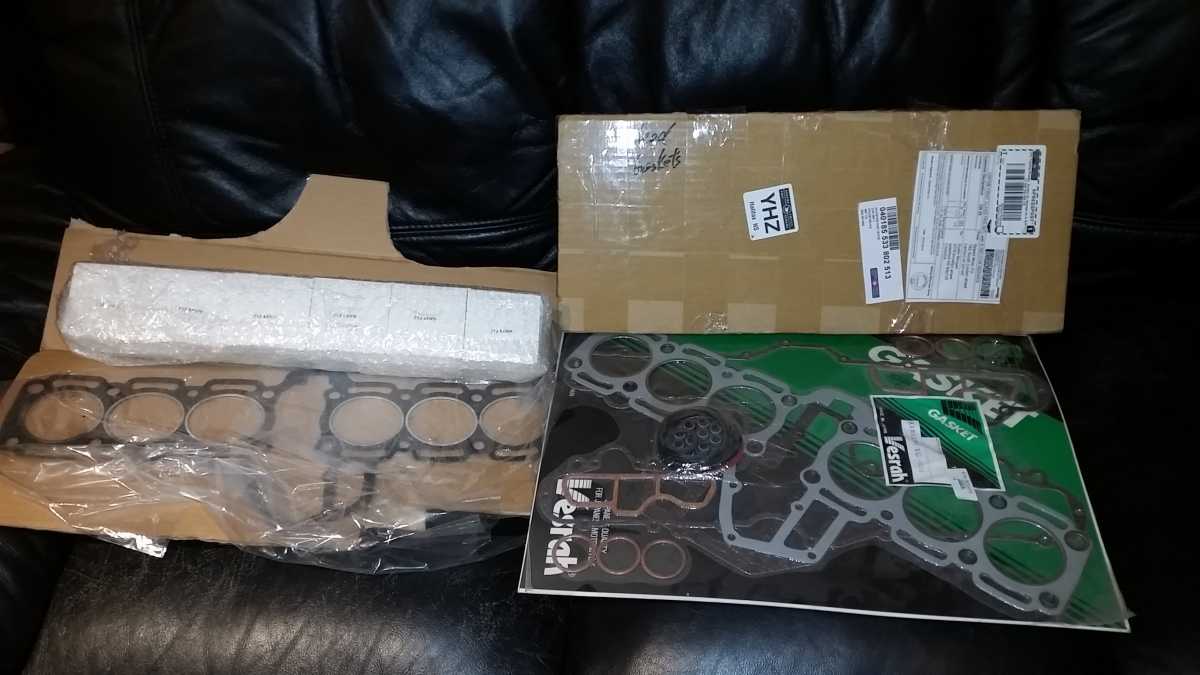

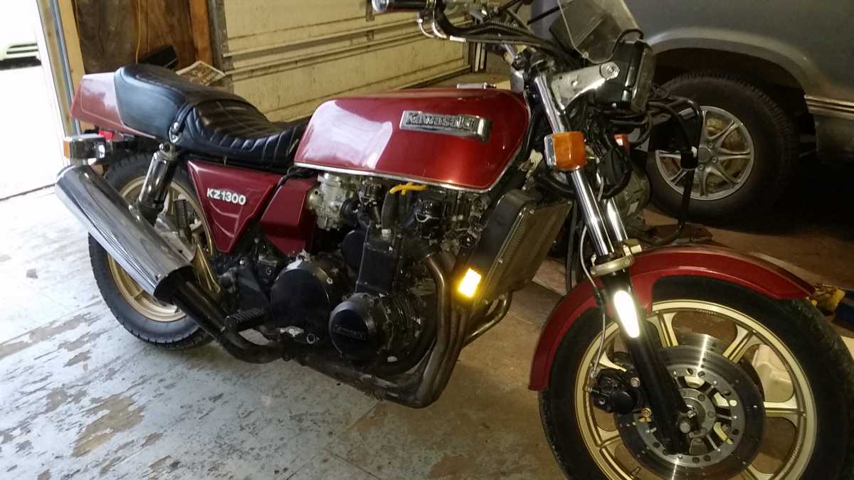

Hi fellows,
I have another KZ1300 that came with a new in the box big bore kit. It also came with a complete gasket set with valve seals etc. This new bike is running but not very well and smokes oil like a train. Right now it seems to have an intermittent spark problem. It was still a steal at $1200 CAD for everything.
Cosmetically, the 79 is in better shape than my 81. My 81 most likely jumped its timing and smashed some valves so I've decided to put the the kit in the 79.
The kit comes with 64mm pistons. I need to get some details on how much the cylinders have to be bored and any other things I need to look at. I won't be doing this myself. I'll be paying someone else since I have no where near the ability or tools to do a job like this.
I read that this bike uses oval pistons. Is this true? What problems does this present with boring the cylinders?
Here are some pics of the new bike and the kit.

My two cents (for what it's worth)- you'll need a good machine shop to do this anyway. If you get them the parts (pistons, bores, etc.), they should know what to do. Just be sure they have as much stuff as they need, and know what you want to do toit.
I was unaware any of these bikes used oval pistons, big bore or no. Again, if the shop has the ppistons as well, they should be able to tell.

Thanks for that info fellas.
Tyler, now I understand what was meant about about oval pistons.
Now I need to find the instructions on the bore. I hope the info is inside the boxes I haven't opened
