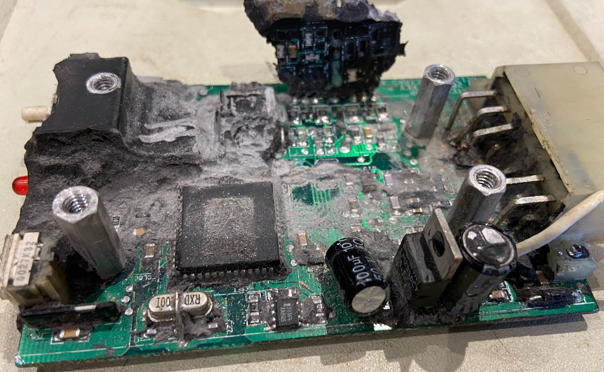

I bought a faulty one of eBay hoping to fix the problem output but removing the resin pulled component from the board and made it useless.
I know Dyna have to protect their design but I bought my Dyna ignition to extend the life of my Z13 and Dyna quickly stopped producing it and removed support. If it goes wrong now it's just tough :-(

Don't be throwing in the towel yet. I haven't seen a circuit board that couldn't be repaired. It's specialty work yes, but somebody should be able to help you out.

I just can't find anything to shift the resin. I had been using a dremel to grind some away. You can see where two of the output transistors are lifted the resin pulled one of the resistors and some SMD capacitors..  There's a lot of green on the underside of the resin which could mostly be lacquer.
I need something that will dissolve the resin. Acetone isn't touching it
