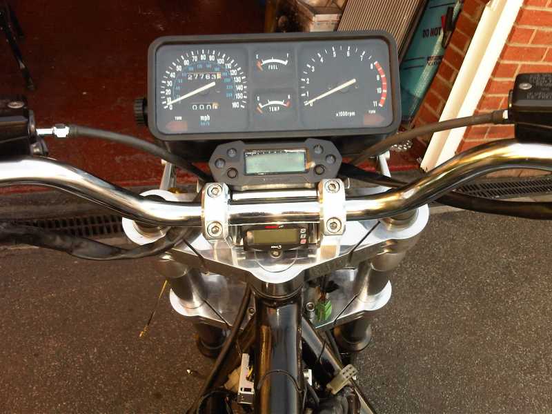

Rob,
I have done this many times as have other owners.
Removing the needles can be tricky & they often fall apart in the process. Its best to do it in a warm temp.
MCG in Germany supply new needles, but its not just a case of slipping them back on..........it can be a long job getting them to run at the correct balance for speed & revs.
I bought a pair of old damaged clocks from a ZRX1100 with white needles & used them.......as it was cheaper than new neeldes. These are white rather than orange.
Hope that helps
