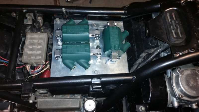

The aw82's look good, but I had a Dyna coil laying around already and picked up two more. They're not too much more expensive, they run less than $60 each new. Plus I already run a set on my other bike (kz650), so now both motorcycles will run the same ignition coils.
The 3 Ohm Dyna coils actually measure 2.6 Ohm, I checked my stock coils and the ballast resistor in series and they measure 2.7 Ohms.
Here is what I came up with to mount them.
