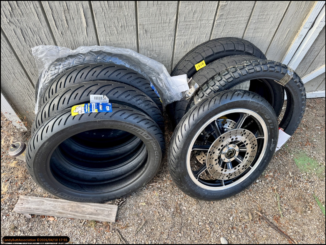

1 month 3 weeks ago - 1 month 3 weeks agoHi Jim, I stuck with the 130's. Hoping the Michelin Classics are slightly taller as I can't lift to centerstand currently without riding on top of 1/2" piece of plywood...What size rear have you chosen for the KZ1300? I noticed some owners have gone for 140 section rather than 130.

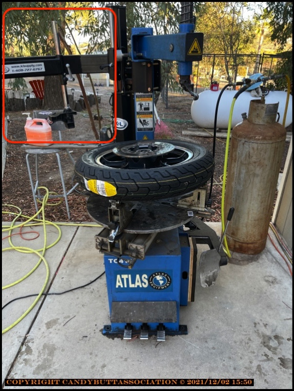

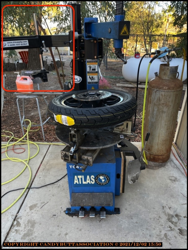

Bill... Agree. The Atlas changer I have has an additional 'foot' to keep the bead opposite the duck head centered... which allows easier install.. It's a brilliant piece of engineering and makes all the difference in the world.
I'm still learning how to properly use the changer. My guess is when all these tires are installed, I'll have it mastered.
...and I started off on rims that aren't pristine, just in case...
...and I off to do more tires!
