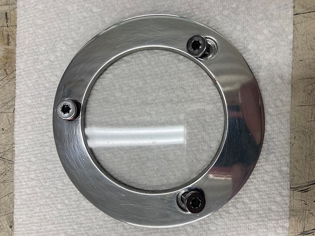

I got lucky 2X. 1 cable broke before a ride and another, after a ride. Handle-end on one and at the clutch release end for the other. Lottery tickets purchased immediately after each incident resulted in $0.00 !
Those events resulted in this.......which is no longer required and up for grabs as I've converted to hydraulic.
