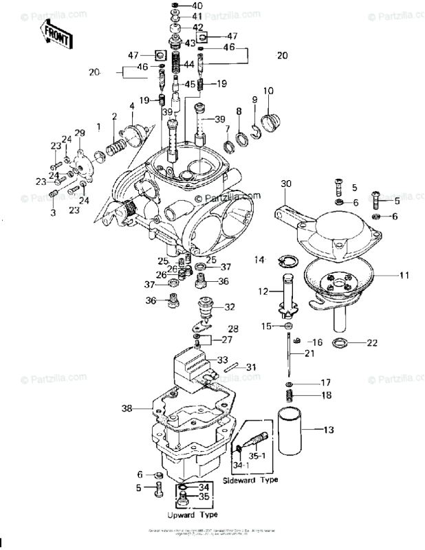

For what it's worth....... I.M.H.O.: I doubt changing out spark-plugs will have any lasting affect.
Instead: Remove the diaphragm/piston from the enrichers (3) and make a solid gasket for under the cover. That will help stop the enriching system from sooting the plugs. This system is redundant anyway if like most - you've disabled the "Clean Air System" - typically by blocking-off the reed-valves and disconnecting the "Vacuum Switch valve". Page #180 in my manual explains how this system was "supposed" to work.

Running rich- If It weren’t for the Keihin BSW 32 carbs on this bike half the topics and half of the posts wouldn’t be on the site. I blamed most of the issues on fuel management lack of understanding and Ethanol now found in 98% of all available fuel. Carburetors made of aluminum and zinc suffer the most and what we end up dealing with is aluminum oxide and or zinc oxide blocking passages, jets and binding of moving parts.Scotch’s flushing tool has helped a lot of our members with shellac deposits caused by leaving fuel in the carburetors for extended periods and the fuel vaporizing off gradually leaving behind the shellac. Some of the oxides may get flushed out but from what I’ve seen, the bond of the oxide to the base metals needs to be mechanically removed, very carefully. What’s really special about Scotch’s Cleaning Tool is the ability to reverse flush the Low Speed circuit and I’ll get to that later.Things that cause carbs to run rich
Carb float Level- The float level will affect all of the different circuits if not correctly set Above all else, first confirm that the float levels are within specs.Carb float needle seat O-rings- The needle seat has an O-ring sealing the seat to the carb body. The original spec’d O-rings were Buna N and that was fine for gasoline. Ethanol blended gasoline causes Buna-N to shrink which could allow fuel to circumvent around the seal between the float seat needle and carb body causing flooding of the carbs over long periods of sitting. Upgrading to Viton O-rings overcomes the issue created by the Ethanol.
Choke plungers not fully seated. This could happen if the plungers are binding in the carb body or the plunger actuating mechanism is not set up properly.
Needle jets with plugged emulsion ports (item #39 in diagram). There are 16 emulsion ports in each needle that are roughly .010” in diameter. These ports allow air in to the needle jets to help break up the droplets of fuel before the fuel enters to carb throat. If the ports are plugged, more fuel will be pulled in to the carb throat and cause rich running. I doubt that most of the members on the site who decided to overhaul their carbs actually pulled out the needle jets and had a good look at them. To remove, you need to remove the main jets and brass washer, and have the piston valves (item #13) removed, then push the needle jets out through the carb throats (towards the top of the carb). All 6 of my needle jets had numerous ports plugged completely with the white oxide. I had to run number drill bits through the holes to clean out then I also used Autosol metal polish to clean the jets up to an as new appearance. Be careful not to open up the emulsion ports beyond original size.
Enrichment Valve seized in the carb body. The Enrichment Valve works in conjunction with the Low-Speed Circuit and sends a rich mixture down the intake ports under deacceleration. I experienced 3 stuck enrichment valves on my 3 carburetors. Scotch came up with a mod to eliminate the Enrichment System and has had great results. Consider doing the mod.
Regarding the Pilot adjusting screws-The Pilot Adjusting screws and the Pilot jets are the main components of the Low-Speed Circuit. I like to think of the Low-Speed Circuit as a miniature super rich carb and by opening up the pilot screws, you introduce more fuel/air in to the Low-Speed Circuit. Now the Low-speed Circuit only functions between Idle and around 2,000 RPM. The Main circuit operates between 1,500 RPM and top end, so there’s a cross over point between the 2 circuits. If the engine stumbles when blipping the throttle from idle to 4,000 RPM, then the issue is probably with the transition ports in the carb throats at the butterfly plates, location. There are 3 transition ports that are well known for plugging and Scotch’s cleaning Tool was specifically designed to flush these ports out in reverse flow to the standard flow of the Low-Speed Circuit. The only way to clear these plugged ports is by reverse flowing a cleaning fluid through the transition ports, pushing the blockage out. Scotch’s Tool is superb in design for doing this and I can’t say enough about it.
