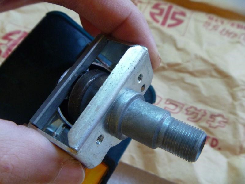

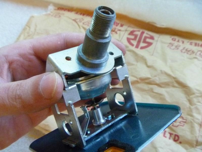

It must be a coincidence but my 79 A1 Z1300 has just started exhibiting the same symptoms. I only recently changed the tacho cable but have checked the drive and cable and all seem to be fine. I have attached a couple of pics from a web search of what is inside the tacho head and it's exactly as Kawboy states; a very simple but crude magnetic system that uses a magnetic flux to drag a cup against a spring - all very delicate I suspect. This is also a job for me over Christmas so I would be interested in anything you discover...
