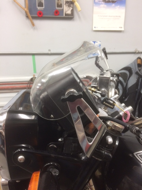

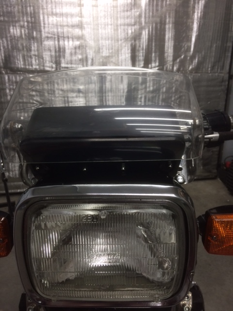

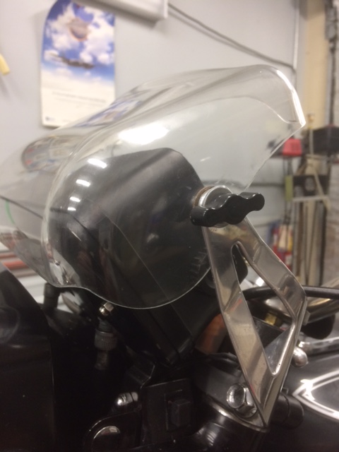

Even after buying a new helmet this year I was still bothered by the horrible low resonance "rumbling" of the turbulent air developed by the front end of the bike. Regardless of how I tried to position myself while riding I couldn't get rid of the rumbling noise which is created by the headlight, signals and instrument cluster. I started playing around with deflectors in an attempt to reduce this noise which was was significant enough to require ear-plugs but even they only reduced the noisy buffeting, marginally. I ended up with a final design solution which works so well, I no longer need to wear ear-plugs. It's a vacuum formed piece of clear acrylic. The shape, size and angle turned out to be critical. What this deflector does is create a smooth laminar air-flow which completely eliminates the "rumbling" problem. Now I can actually hear the engine and that sweet exhaust tune!

Nice Fab job scotch !!

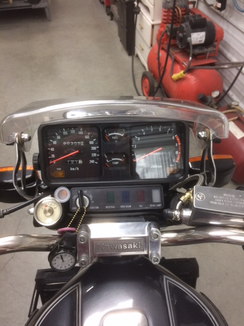

Just looking at your instrumentation panel Scotch and thinking if you added a turn and bank indicator and an artificial horizon you just might be able to fly the bike rather than ride it. I see a few do-dads there that don't normally show up on a bike. Are you sure you didn't work in Nuclear?

Nice job! Doesn't detract from the original look of the bike either.

From kawboy: <"......if you added a turn and bank indicator and an artificial horizon you just might be able to fly the bike.....>"
I'm not IFR rated so the additional instruments would not help!

Looks like the touring version, small edition to me. Nice job !
