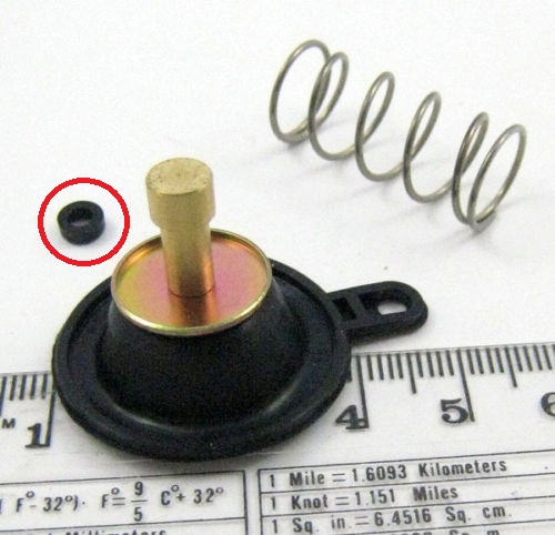

Finally finished work today and have just over 4 weeks off, time to look at the old 13 again, riding it to work almost every day I don't get a chance to really do a lot to it during the year. Finally got around to cleaning my spare set of carbs, soaked in diesel for a week, blew out all the lines even used the special cleaning tool I got a while ago, had to order 3 air cut off diaphrams as the old ones were pretty stiff, took a while to get here, now if someone could explain what the hell they do would be good

BTW Don't know if you were serious about having the air cut off diaphrams explained? But if you were it is pretty well explained on Page 168 of the manual with a nice diagram as well.

Yeh read up on them diaphragm thingies, changed 'em, got it all back together yesterday, still have to pull off the ones on there now and swap over the floats, I have the brass ones in the ones on the bike, everything went back together well, amazed me I didn't have any "spare parts" after I finished

Maybe you can enlighten me on installation of those diaphrams, what and where does that small o-ring type thingy get installed? I can't find a reference to it in the manual.

I couldn't find anywhere to put that little thing either, so I have 3 "spare", and don't forget to put the cap on that spring from the old set, still have to pre-adjust the balance shafts before I put them on, noticed one was a little worn in the bottom of the slot, but it should be ok (fingers crossed), took the idle screws out 4 turns just to start it, as I said it all has to be tuned and balanced after I swap them over, not looking forward to those bloody rubbers on the air box, hopefully I have the carbs together in a reasonable place on the rail, no rush, still have a few more weeks holiday, cheers
