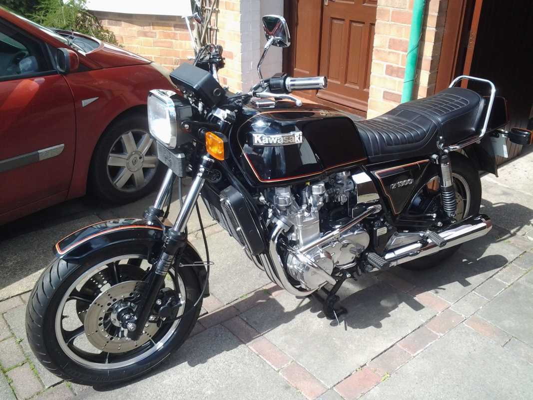

Hi Guys. Would like to receive your input re what its worth. Please read the following then the pictures.
With deep regret I'm going to move on my Z1300 A3. For the past 2 years she has been given the TLC that deserves, rather than go to the scrap yard.
The following is the work that I have carried out. Starting at the front end. Forks stripped down checked and rebuilt with new seals and oil, brake callipers stripped and cleaned with new seals and fluid same for master cylinder, Tank repainted to a very high standard, Coil conversion with new leads and caps plus plugs (done away with ballast resistor)New air filter and battery (motobat)
New 6 down pipes and collector boxes and right hand muffler (orig Kawasaki)Carbs stripped and cleaned, New out of the box seat unit, Rear brake calliper stripped down with new piston and seals, rear diff oil change plus engine oil and filter change. The bike is very clean and tidy. But one problem that I have is an intermittent spark :evil: one day she will fire up 12 times and run as sweet as a nut. The next day no spark. Have been on the forum many a time re problem and checked every thing that advised to try, and thank you all for your input. Its not the ic unit as purchased one from Lauri to confirm (must say that his units are spot on)Bike fitted with new tyres. Think that's about it re bike. So come on guys please give your input re how much you think its worth?
Would be a shame to strip down for spares as the donkey work has been done.

It looks like a 7 grand bike every day of the week to me Dave, a dealer would want a load more,would be a pity to sell it for a big chunk less due to an annoying problem but best of luck and hope you don't give it away

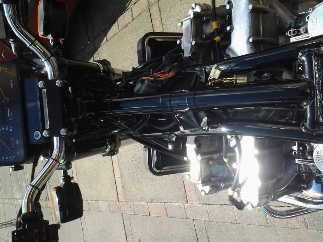

Dave, that frame looks like it has been painted recently I might be wrong but it look great in your photo's. Have you checked all your earthing points, along with all electrical componants such as coils ignitors etc that they are earthed to there mounting points i.e you havn't got new frame with paint preventing good earths.
Remember your frame is the electrical return to your battery etc.
