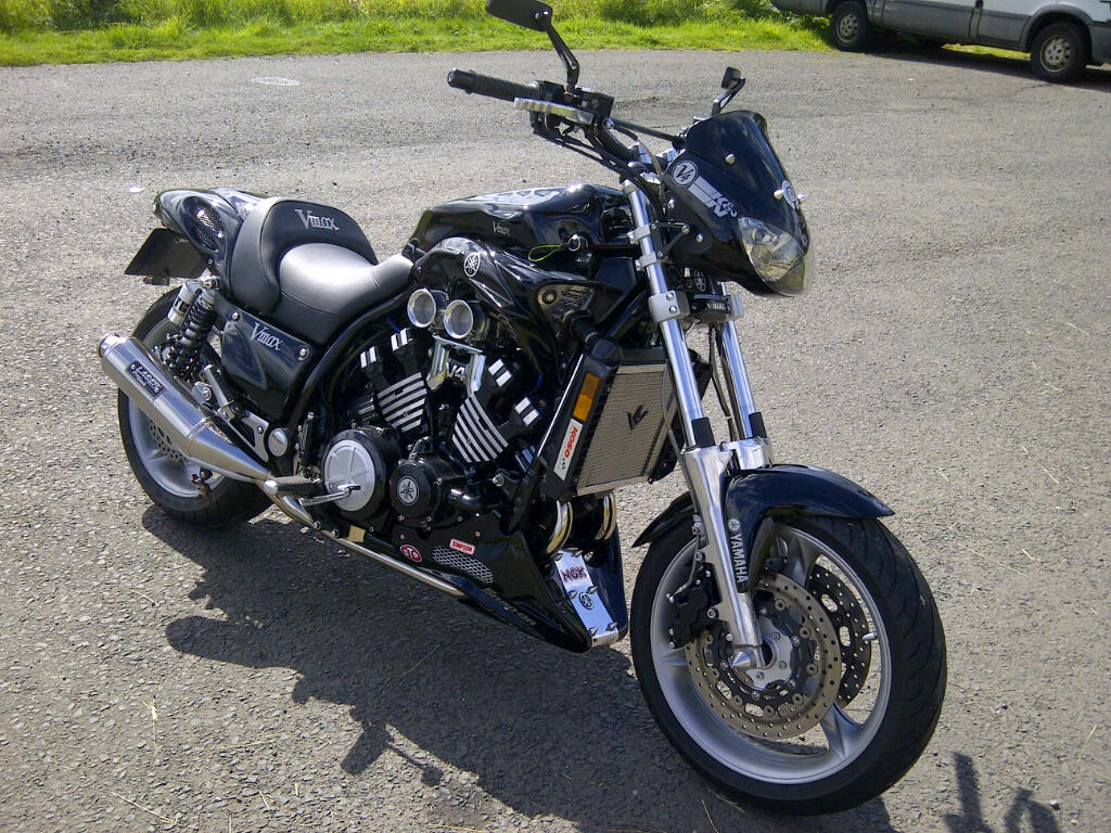

Ive not been able to run my Zed13 for a couple of months due to her being sick - Ive actually been running around on my latest resto project a Vmax1200
Been impressed with this bike: really lovely engine.

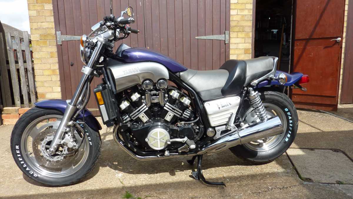

Nice to see another 1300 owner with a Vmax............my other favourite bike which I am current riding too.
