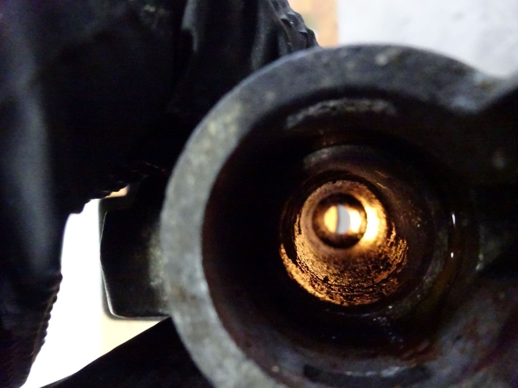

The rear brake on my A1 has never really worked as well as I wanted – a little too “soft” in feel. On several occasions I have tried to remove the scores and ridges in the master cylinder but these have generally been too deep to remove using the usual “wet and dry paper on a stick” approach as others have recommended. The picture below shows some fairly deep radial grooves that I was unable to polish out. I have found it increasingly difficult to bleed the brake with a stream of small bubbles emerging from the bleed nipple even after I’ve gone through around half a bottle of brake fluid.
