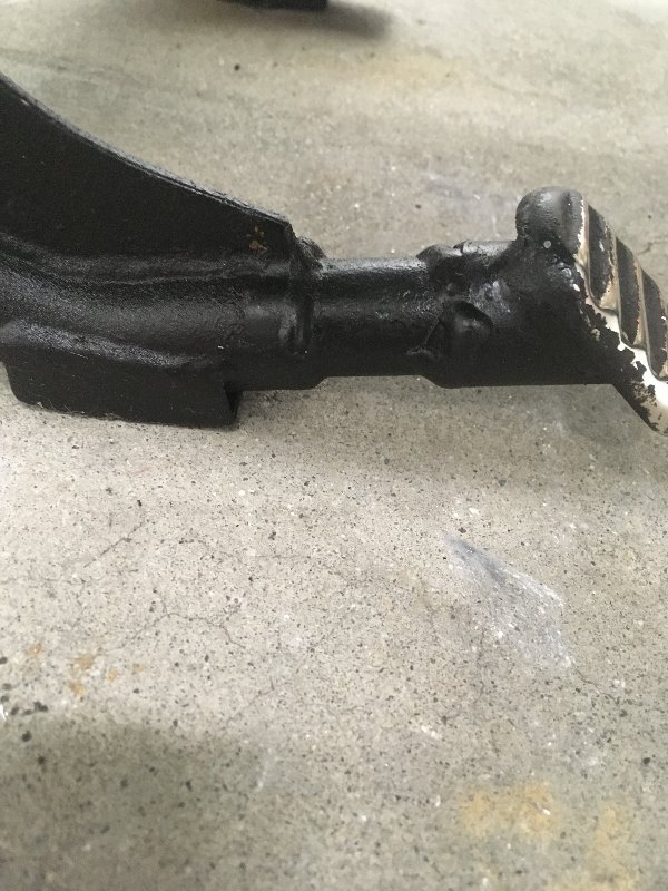

scotch wrote: Or.....You can shorten the C/S legs by 5/8" and add an extension to the toe-pad.
Ultimately, me thinks this is the answer. I have a good fab shop 20 miles away. Just may source a used centerstand and get to cutting and welding...
