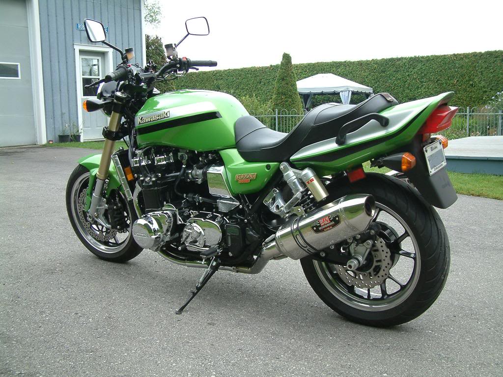

Then there's Robert Bolduc's ZRX1200R with a KZ1300 transplant. Drop dead georgeous !!
That is so good looking

That Canadian KZX 1300 is perfection in my book
