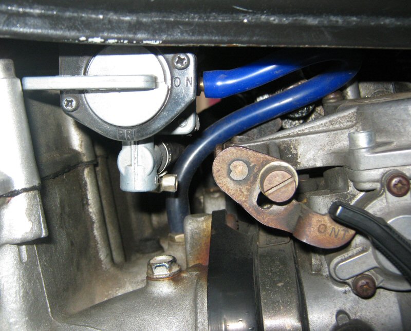

I used a Kawasaki vacuum petcock on my 1979, i'll attach a photo to show where to hook up the vacuum line, as was said it's one of the connections to balance your carbs, just take the bolt out and put in a nipple
