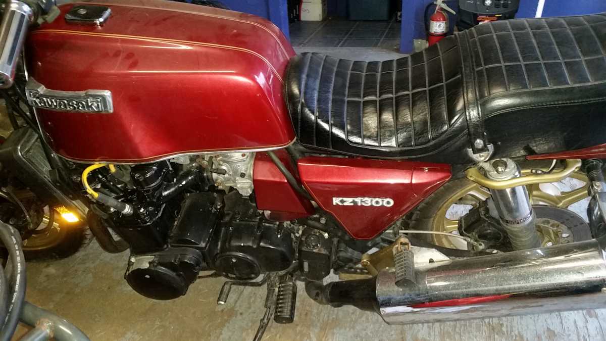

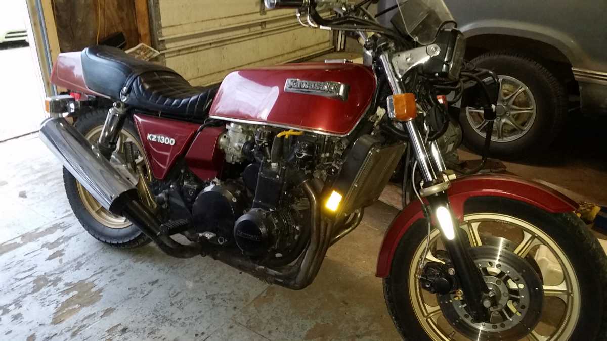

Well... I went and bought it. From a purely cosmetic perspective it is much better shape than my 81. The seat is mint so that saves me $300 right away to have it cut down and re-covered. It has a couple of other pieces I was looking for such as the front fork brace and chrome rad cover. The front forks are in far better shape and the fork seals don't leak. Stainless lines in front is another plus.

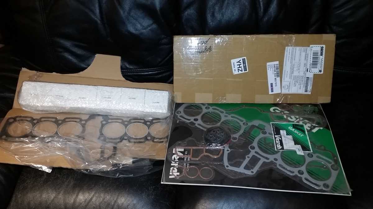

It started right up and I drove it home. As he indicated, it does smoke so good thing it came with a big bore kit and all the gaskets. The pistons are labeled 64mm.
One crappy thing... the starter switch is baked like my 81 so it will need to be rebuilt or replaced. The rear brake don't work so it is a good thing mine are great.
Here she is

OOooooo.... looks pretty sweet!
Not sure if they're included (looks like they might be), but while you got the motor tore apart to big-bore it out, be sure the valve stem seals get changed as well. If the motor smokes all the time bad valve stem seals probably AREN'T the reason why, but you can only change them by pulling the head. May as well get it done while it's apart.
(You'll also find that certain big bore piston parts (rings in particular) are actually SUBSTANTIALLY cheaper than standard size ones. For whatever reason. While rebuilding mine, I actually seriously considered popping a big bore kit on it, if only to save me a bit of cash.... O_o )
