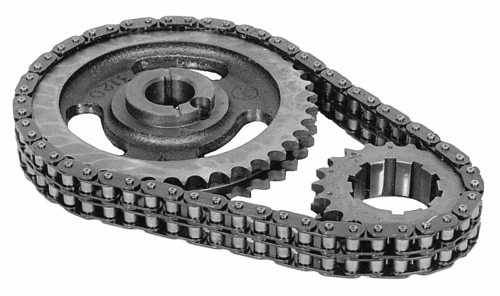

I've said this in another thread but for sake of discussion I will add it here. I put Liska timing gears in place of the rubber roller on the tensioner in my kz650 and replaced the top idler( that was a metal gear with a rubber core) with a Liska part as well.
Right away I noticed the noise, even at proper chain tension it sounds like a loose chain, anything under 4,000rpm and you here it clacking away. Keep in mind my little 650 has a roller chain not a hy-vo like the 13's. It is pretty clear why Kawasaki used plastic and rubber components.
In general my experience as a mechanic plate-link type chains (HY-VO, Silent chain, etc) have a limited life span. In high performance engine builds, they will often be replaced by a double roller type chain. I know this is not possible with the 1300 so I would simply say that regular service and inspection is a must with these engines and that they will require periodic service and replacement. They are a high wear part and just like anything else in the engine they can wear past their service limit. I don't think using a steel roller is going to change that fact.
here is a timing chain for a "boss" 302 from ford racing...
BMW uses a timing chain like this in their air head motorcycles, they run 100's of thousand of miles on those engines.
