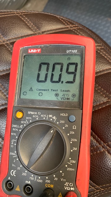

I do not have a 1 Ohm meter, but at 200 Ohm this was the reading for each of the three yellow wires:
Doesn't mean much I guess..but it was consistent between all of the wires.

The resistance measured is within spec, so that leads me to believe that your voltage check was not done as per manual. The output of the stator is +50V AC between 2 of the yellow leads and to do the test measure between lead #1 and #2, between #2 and #3 and between #3 and #1. ( Note that you can name the leads as you see fit) The point is that you need to check the output between each of the 3 leads to the other leads. I'm going to suggest that maybe you had the volt meter on DC or you were checking the output of each lead between the lead and ground??
