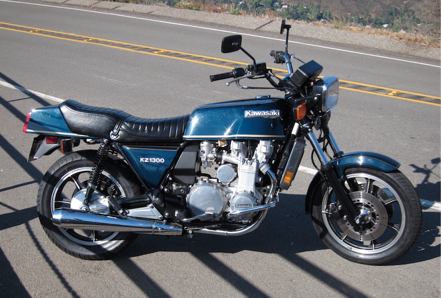

That's 1 beautiful looking 1300. Love the paint. I can see the metalflake down below. Must be hard to look at in the bright sunlight. The rest of the bike looks spectacular.

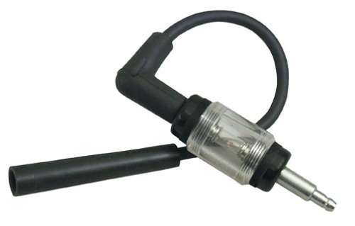

Ron wrote "I have this tool that checks for spark (a small clear plastic tool that you put between
the plug and the plug cap) and it shows that there is spark, I tired a new plug then thinking
maybe the plug fouled, still no spark. I’m lost… would appreciate any help. Thanks, Ron. kz1300.JPG"
Does this "tool" look like this?
If so, that will show if a spark is being generated, flowing down the spark plug wire , jumping the gap in the tool and having a pathway to ground. That indication will show even with an oil fouled plug because the plug is now shorted to ground completing the circuit. The tool will not tell you if the spark plug is shorted and oil fouled. if it ran the day before and then dies on 3 cylinders when you started it up the next day, there's a strong possibility that some of the plugs oil fouled

Yes, this is the tool i have.
So how would you explain a new plug not sparking? ( and the tool shows that there is a spark)
