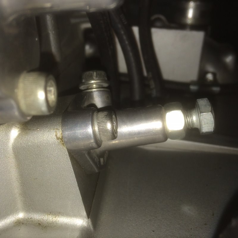

9 years 3 weeks ago - 9 years 3 weeks agoscotch wrote: The photo should help qualify the mod to the OEM tensioner. What can't be seen is the "Internal" nut that's immediately opposite the exterior lock-nut. The internal nut was "rounded" to fit snuggly in the very end of the bore in the tail-piece of the adjuster. There's more, but I'm not going to complicate this further, at this point. Hope this helps somewhat.
Thanks Scotch - it mostly makes sense. I'm trying to figure out what the little bolt on the backside of the tensioner does? And so there's actually a nut you machined that goes into the thread area just past where the exterior lock nut is seen in the photo? And sorry for asking, but what is the necessity behind that internal nut? The exterior one alone is insufficient maybe ..

Thanks Dion - I appreciate all that. So quickly, what kind of oil do you run in the KZ13? I just changed mine and used Kawasaki SAE 10W-40 and an Emgo filter (it's the only one they had in stock that would fit the bike). But I'd be open to suggestions. I also used the Kawasaki 80W-90 gear oil for the rear diff, and I noticed it has an additive for Limited Slip - is that okay?
And on the CCT, I think my original post was misconstrued - when I said I have done adjustments with the bike running, I was implying that it was on a warm bike, engine idling (not running or riding persay) .. which sounds like what you all do?
