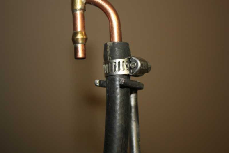

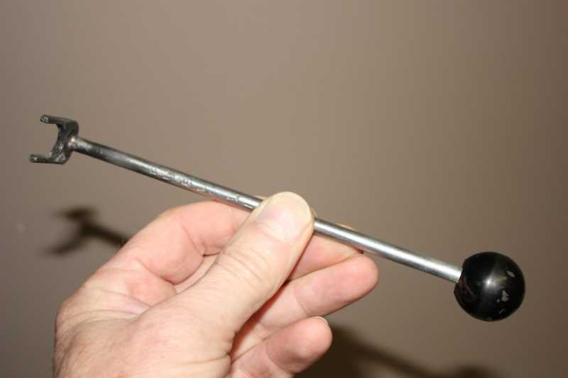

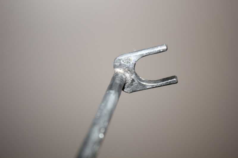

And then there's the issue of getting the fuel-line off the fuel-valve barbed outlet ! I've heard lots of complaints and justifiably so. It can be tricky for the uninitiated.
I'm lucky in that Iv'e got long fingers so getting both my index fingers in under the tank to wriggle the line off hasn't been that bad but; get a drop of fuel on the line and it gets too slippery to pinch and push. I came up with this: Another home-made tool that works perfectly for this task. By placing the fork on one side of the clamp or the other (In my fuel-line routing case the clamp at the inlet side of the fuel-filter), I'm able to push the line off or pull the line on. Pulling the fuel-line back onto the barb only requires that I align the end of the line with the barbed end of the pet.-cock. Once aligned I can easily pull the fuel-line back on.

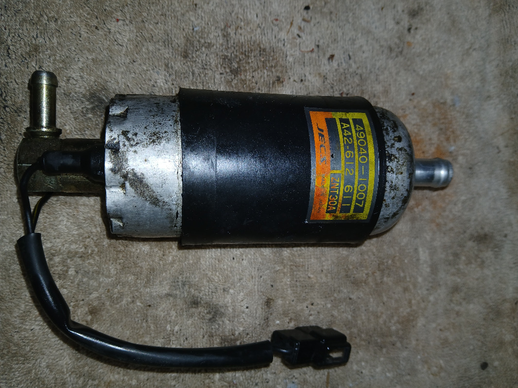

OK, Yes I've resurrected this ten year old thread partly because it contains some good information and because:
I need a fuel pump.
This would be for my fuel injected '85 Voyager.
The stock pump is a JECS
ZNT 30A
A42-612 611
49040-1007
I haven't been able to find anything OEM and the wider retro/custom market will require more investigation on my part.
The OEM pump looks like this:
Have any of you folks been here before?
