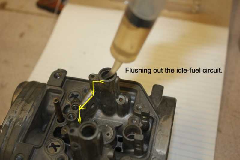

Need help. I'm obviously, not capable of figuring this out on my own.
I have two carburetor racks. One is original equipment, the other one from eBay.
I have cleaned both numerous times using the scotch tool, syringes, compressed air.
The best I can tell, all passages are open, including the pilot jet transfer, the ones that run at a 45° angle to the pilot jet from the bottom of the emulsifier fire tube.
Having said all that, I still don't have any real adjustment, if any when adjusting the pilot jets.
I have had both racks on and off at least a half dozen times now.
One lucky time, everything worked great! Every pilot jet had adjustment, the engine would stumble when closed, and in RPM would pick up when the chat was open to about 2 3/4 turns.
