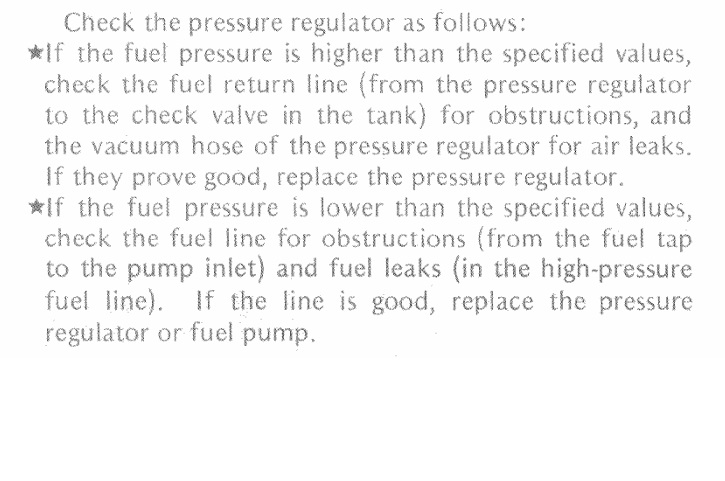

Reading through the Digital Fuel Injection System in the ZN1300 Service Manual, on page 3-24 it suggests that the fitting in the tank is a check valve.

Perhaps the relief valve is just a port to vent excessive pressure from the injection system, as determined by the pressure regulator, AND it's a check valve to prevent fuel from draining back from the tank should something go wrong with the injection system during down times. I've tried blowing air through it but it seems totally blocked.
