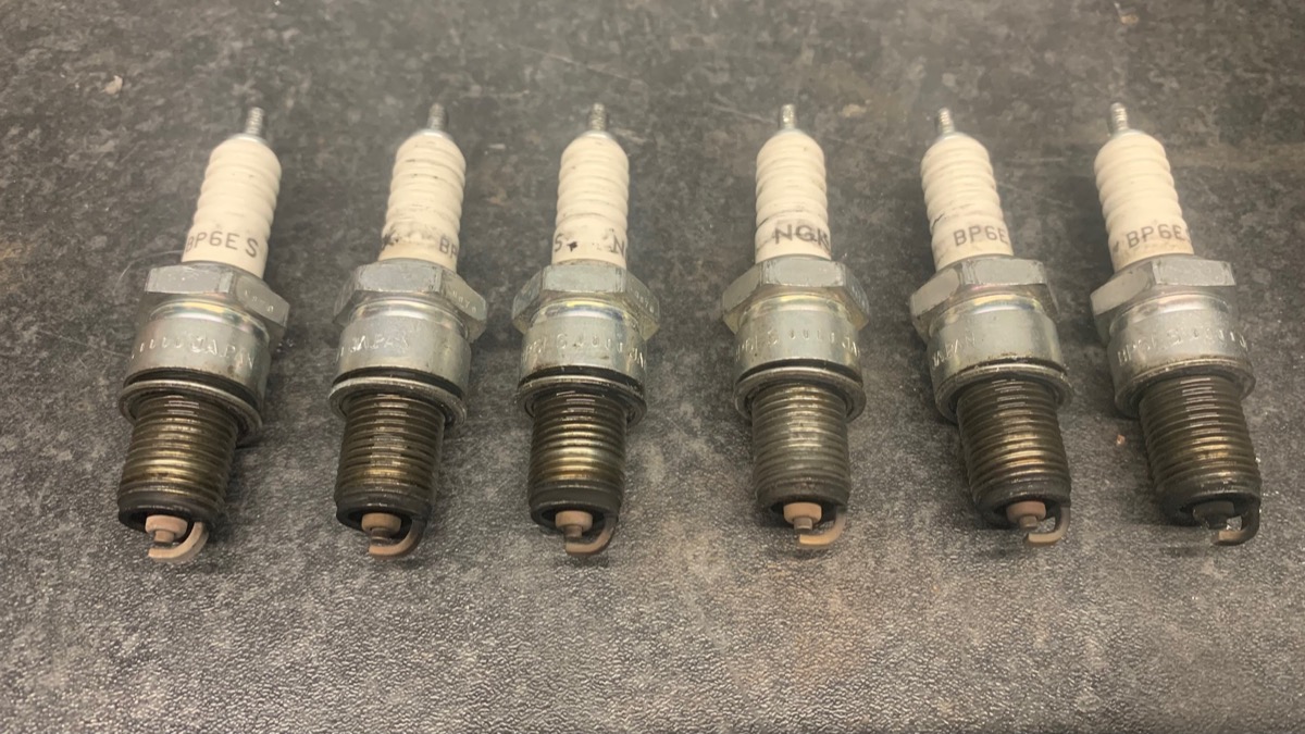

Re: Hesitancy upon take off
3 years 11 months ago
Ok, I've done some 75 hard miles and this is what the plugs look like now. A little twist in on no 1 and out on no 6 and I think we are there.
However, it idles ok, but taking off and at low revs it is still quite lumpy.... as though running on less than 6 cylinders.
I think I may need to either clean the pilot jets or order a few new ones.
Considering I have increased the air flow by modifying my air intake to two air cleaner cones, will I need to change pilot jet size as well?
Paul
Paul
