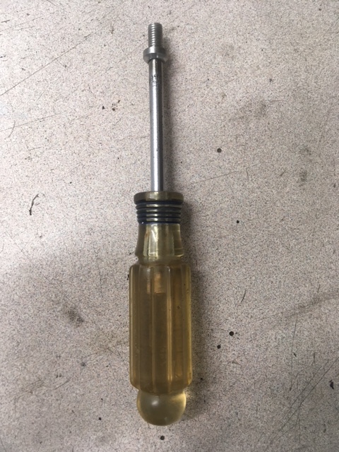

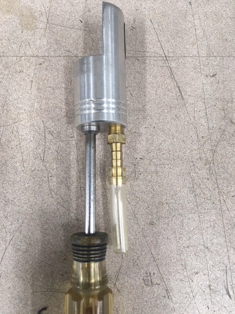

This and future production runs will include a 1/4X20 threaded hole to allow the user to make a handle to aid in insertion and removal. The "handle" can be as simple as:
OR
OR, as I preferred, a modified screw-driver:
OR
