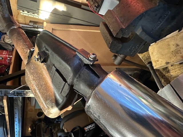

These were a bugger to separate, had to scrape the gasket material out of the joint, peeled the flanges back even further than the pic shows, used heat, lube, and a bigger hammer. Finally got them apart.

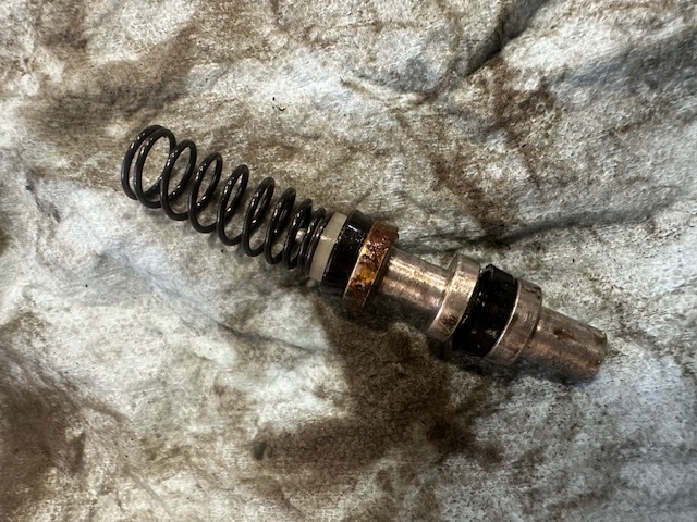

Refurbed the rear master, actually in decent shape, although gummed up. The bore was clean, and the plunger will clean up nice.

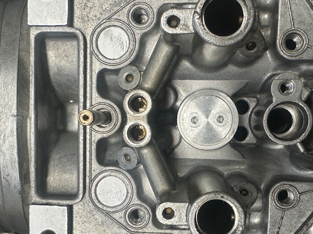

Disassembled the carb rack, for a deep clean and a new carb kit. Main jets are 110R. The small pilot jets were in there real tight, in fact much too tight. I used a perfect fit screwdriver and still wound up with a difficult time to get the jets out after the heads of the jets were distorted. Only the middle carb was I able to get the jets out without issue, the other 4 took time.
Used a lot of carb cleaner and compressed air to get all passages cleaned out.

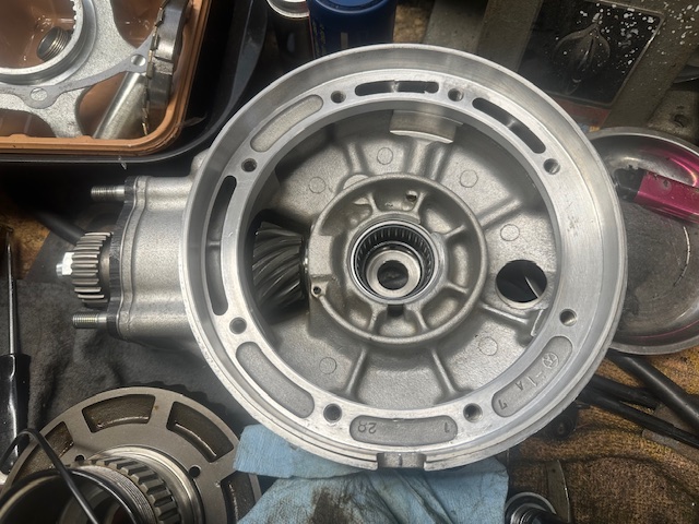

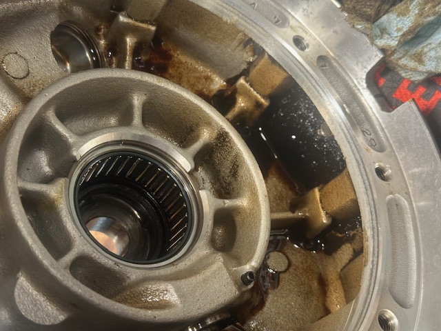

Disassembled the final drive, lots of crud in there, but otherwise in great shape.

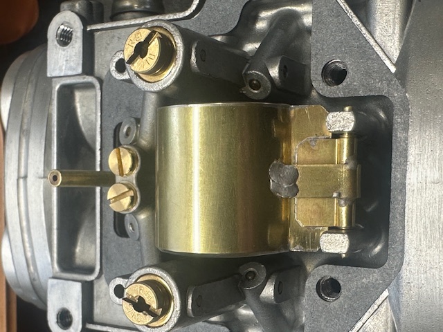

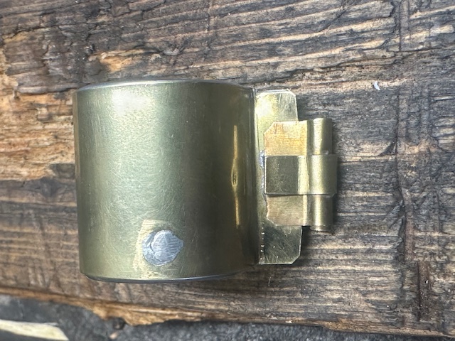

Took out the old nitrophyl floats, and although they hadn't absorbed any fuel over the 5 days I had them submerged in a jar with added top weight, I decided to get a set of Scotch brass floats.
Here's one installed,
All three had a solder blob on the underside of the float, is this part of the manufacture process or a mistake repaired?

Your question on the blob of lead on the barrel of the float. You'll find this on every brass float manufactured. A small vent hole is required to relieve the pressure inside the float when its heated up to solder on the sides of the float. If the hole wasn't there, as you close in the final part of the solder joint, the pressure inside the float will blow out the solder. When you go to close in the vent hole, the float is heated up to expand the air in the float and as it starts to cool down, you quickly fill in the tiny vent hole and allow the slight vacuum that developes to pull the solder in. Typical vent holes are 1/64" (.015").

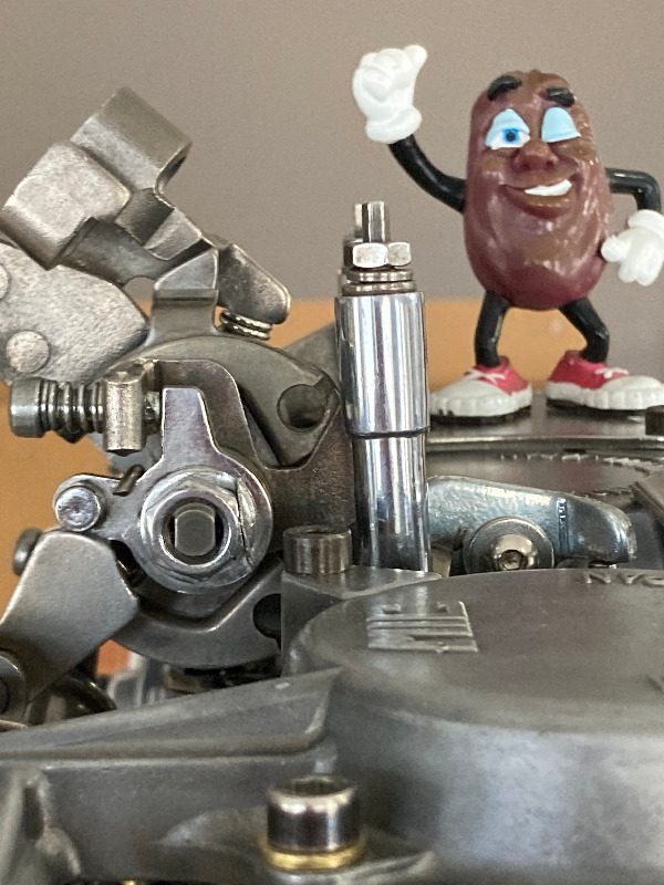

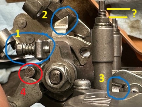

Got the carbs back together, and was doing a static setup on the bench.
Got a few questions re: the static setup.
The stop has no clearance, the idle gap is .55 mm per the manual, and fast idle adjusted to accomodate the closed position on the stop.
Then the choke set at the highest position opens the throttle valves to provide necessary choke. The synch adjustment screw/nut I had turned in lightly to bottom and then turned back out 1.5-2 turns.
I also set a .006" gap at the throttle plates without the choke as a baseline. The choke opens the throttle valves, but closes to idle position once I get it past highest point on the cam.
It seems that the idle adjustment knob won't have an effect until I take up that .55 mm slack.
In saying all that, I'm not sure if I have this static setup correctly done.
I did read a bunch of threads and the manual, but it's still not clear 100% .
Any help appreciated.

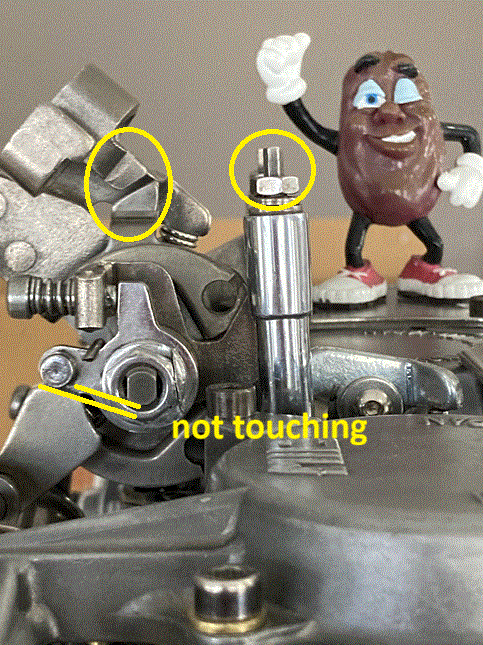

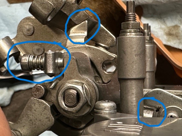

1 month 1 day ago - 1 month 1 day ago1 - Compared to all of my set-ups - all 3 appear to be turned out too far
2 - This should never be touching under normal circumstances. There should be approx. a 1mm gap when set-up is correct.As it is; This is now acting as the Idle stop.
3 - This gap should not be present with the Choke OFF. It exists because your set-up is incorrect. This refers to #2 point. It could exist if your throttle cables are adjusted correctly.
4 - The roller should never touch the cam with the choke off. An inconsistent idle will result.
Start over, beginning with a .006" throttle-plate gap.
Ignore the manuals recommended 0.54 - 0.55 gap page 50 E21. I've never been able to get a set of carbs to operate correctly at this spec. The gap on all the carbs I have rebuild including on my 2 operating bikes and two spare (tuned) carbs is closer to 1.5mm. When I adjust everything on a set of carbs and before I attempt to start the engine, I preset the idle (that long one between the left and center carbs) to achieve the 1 - 1.5mm gap. This usually gets me in the "ballpark" for an idle; prior to Sync'ing and "Color Tuning". It helps avoid a redline run-away !
