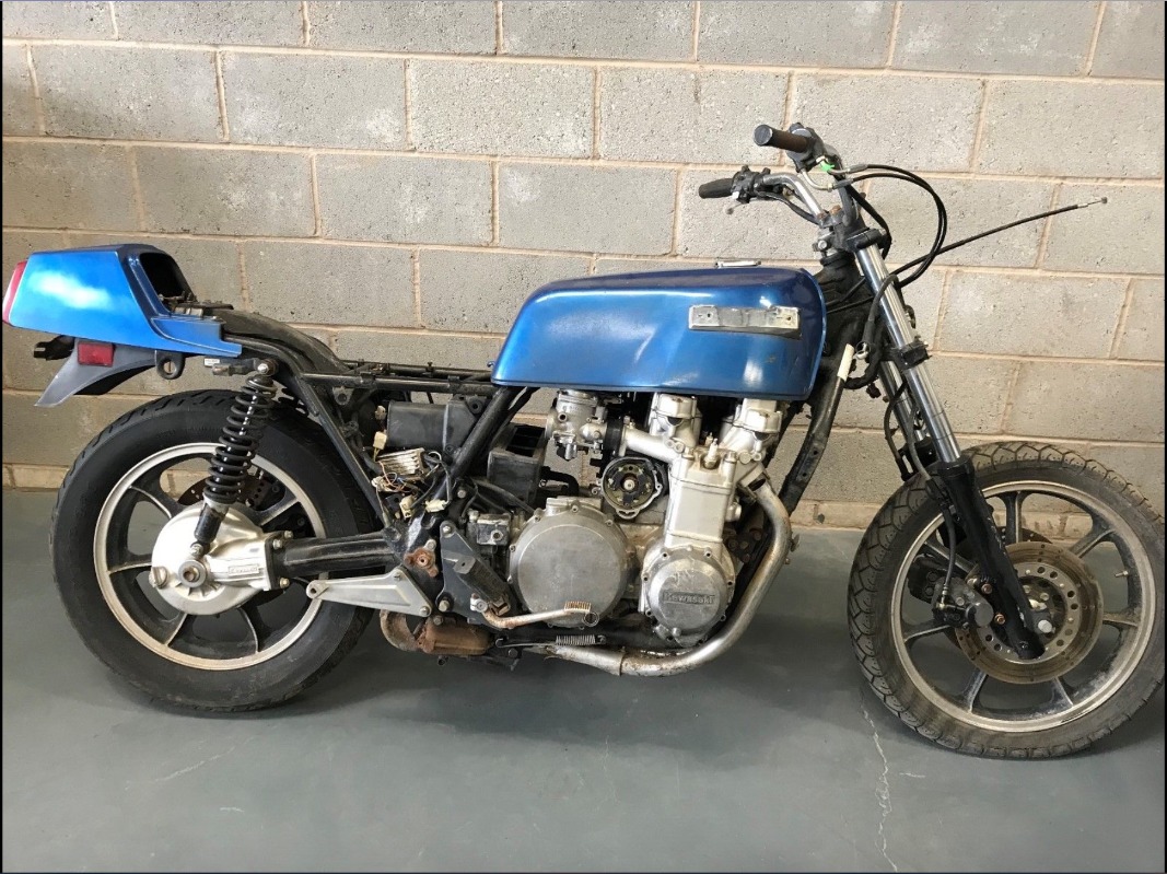

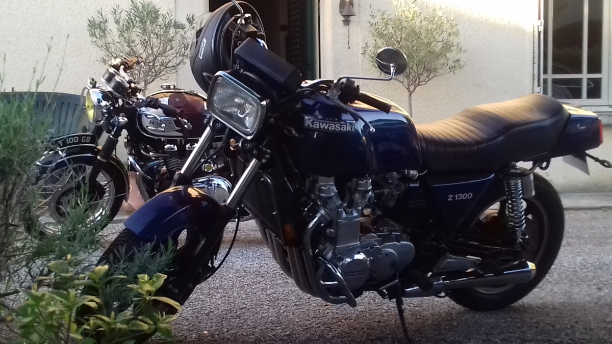

First pic is the bike as I bought it. Other pics are after a few rides

Oh I seem to have lost a couple of pics. Here's the first pic of the bike as I bought it.

That looks fairly tidy compared to what I bought a year and a half ago!
