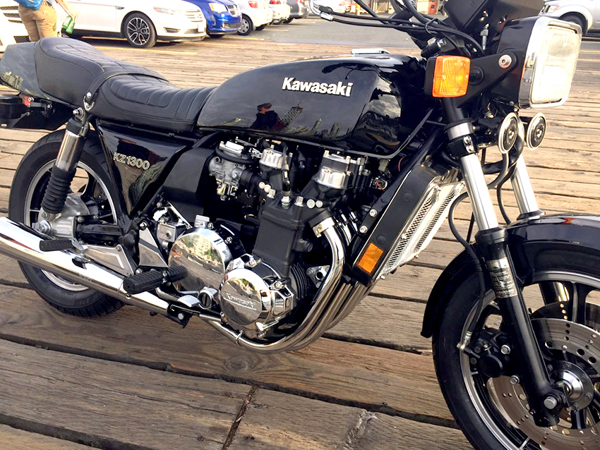

Actually the 1982 A4 model was in the US. It came with a 'peanut' shape tank. They are rare, I've been actually told this is the rarest of the models therefore rarely seen. I heard 'California' referred to them, and mine has the 'CA' in the VIN serial number (most available are A1 - A2). The A4 comes with all the latest whistles of the carbureted models, including two alternators and those discussed 20 holes pistons, the engine is very wide because of this (not the pistons lol). I've literally built mine from scratch including chrome plating all that you see (and some you don't). It was a messy wreck with most parts missing, but only 8k miles, so pretty much a new bike after putting all new in the top end, and every bearing, seal, brake system component, as well. The black is standard Kawasaki ivory black, but I put off adding the stripes for later - I like the modern twist to this bike with this black theme. Sorry for bragging but I put so much heart into it! And yes, I built in my living room!! haha
There are also 'naked' ZG models, and they are fuel injected. I think these were European.
