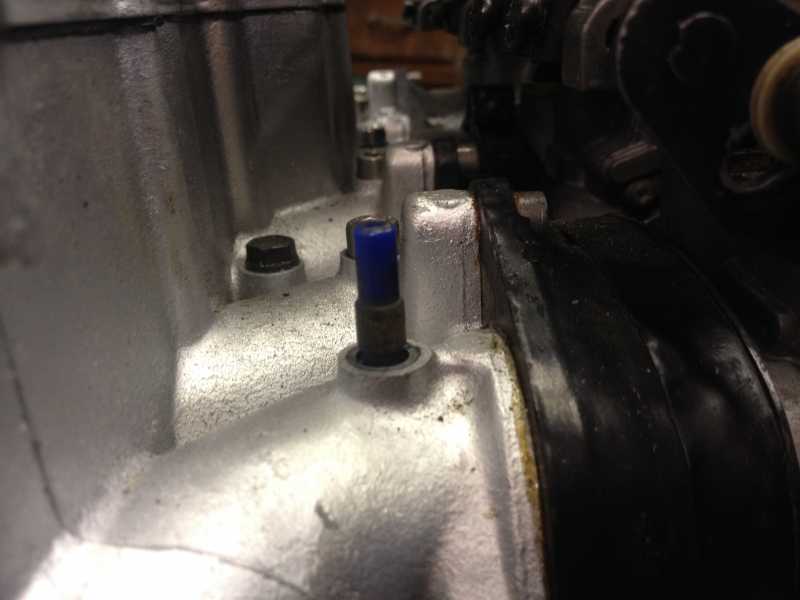

OK if any of you ever see me feel free to give me a slap round the earhole for expecting the tap mesh to filter out all the fine crap from the tank.
just spent the afternoon stripping the carbs and blowing out all the crud.
drained the tank down and washed out a load of fine red dust
ive swapped the fuel tap for a vacuum operated GPZ tap
and ive taken the vac pipe from the No1 inlet
crude but effective hopefully
